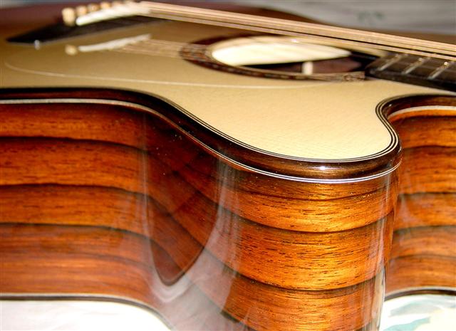

PostPosted: Mon Dec 18, 2006 6:42 am
I have always loved this look.
I have no idea how Mark Blanchard does this, by hand or with a jig or tool of some sort, but I sure like it.

PostPosted: Mon Dec 18, 2006 9:22 am
Posts: 1041
     I use a sharp scraper to bring the edge to a chamfer and then make
several passes to blend that into both surfaces and finish up by sanding. I
do round things a little more than some builders and usually end up about
where the Blanchard guitars do.
     I haven't talked to Mark in a while and the photo made me think of it. I'll
have to give him a call or drop him a note to say hello and to wish him a
great holiday.
   Mark's guitars are beautiful and he is a wonderful guy.
